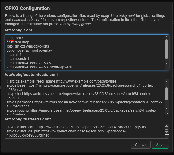

    第三方特殊插件
    因为是Qualcomm,在/etc/opkg.conf多加settings,如果MediaTek,就不需要加。
    /etc/opkg.conf
    1. arch all 1
    2. arch noarch 1
    3. arch aarch64_cortex-a53 5
    4. arch aarch64_cortex-a53_neon-vfpv4 10
    /etc/opkg/customfeeds.conf
    1. src/gz base https://mirrors.vsean.net/openwrt/releases/23.05.6/packages/aarch64_cortex-a53/base
    2. src/gz luci https://mirrors.vsean.net/openwrt/releases/23.05.6/packages/aarch64_cortex-a53/luci
    3. src/gz packages https://mirrors.vsean.net/openwrt/releases/23.05.6/packages/aarch64_cortex-a53/packages
    4. src/gz routing https://mirrors.vsean.net/openwrt/releases/23.05.6/packages/aarch64_cortex-a53/routing
    5. src/gz telephony https://mirrors.vsean.net/openwrt/releases/23.05.6/packages/aarch64_cortex-a53/telephony
    /etc/opkg.conf (需要加)
    1. dest root /
    2. dest ram /tmp
    3. lists_dir ext /var/opkg-lists
    4. option overlay_root /overlay
    5. arch all 1
    6. arch noarch 1
    7. arch aarch64_cortex-a53 5
    8. arch aarch64_cortex-a53_neon-vfpv4 10
    /etc/opkg/customfeeds.conf (需要加)
    1. # add your custom package feeds here
    2. #
    3. # src/gz example_feed_name http://www.example.com/path/to/files
    4. src/gz base https://mirrors.vsean.net/openwrt/releases/23.05.6/packages/aarch64_cortex-a53/base
    5. src/gz luci https://mirrors.vsean.net/openwrt/releases/23.05.6/packages/aarch64_cortex-a53/luci
    6. src/gz packages https://mirrors.vsean.net/openwrt/releases/23.05.6/packages/aarch64_cortex-a53/packages
    7. src/gz routing https://mirrors.vsean.net/openwrt/releases/23.05.6/packages/aarch64_cortex-a53/routing
    8. src/gz telephony https://mirrors.vsean.net/openwrt/releases/23.05.6/packages/aarch64_cortex-a53/telephony

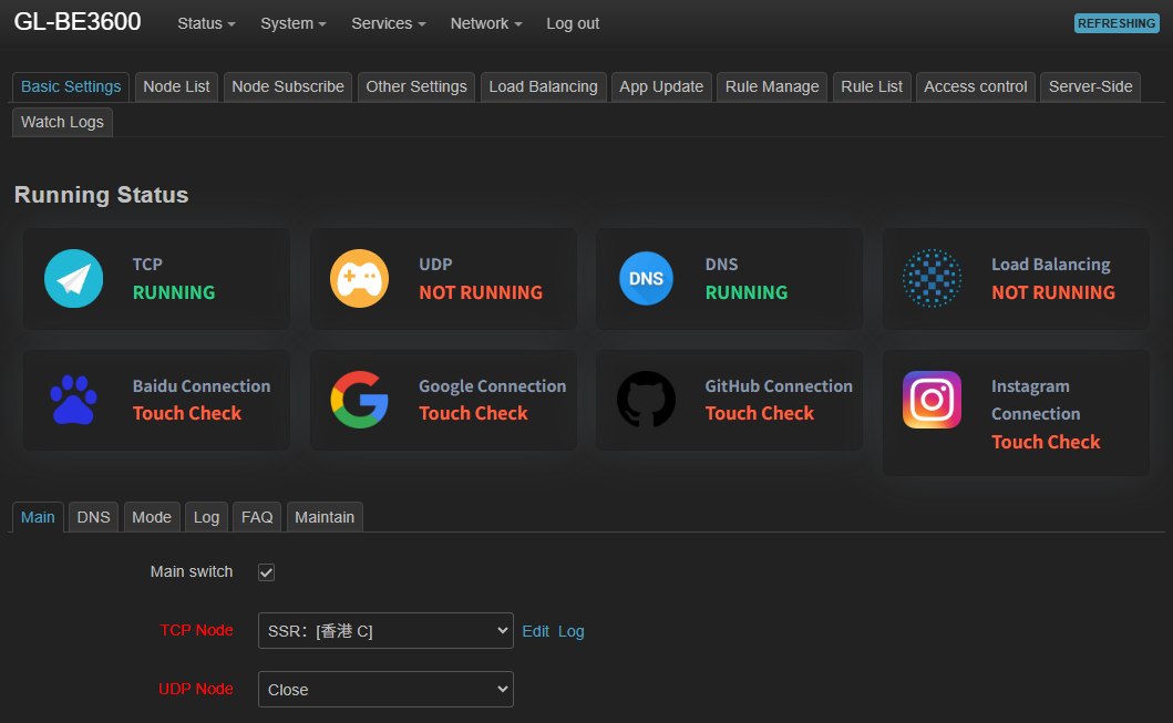

     楼主| 发表于 2025-10-7 08:29:48 | 显示全部楼层

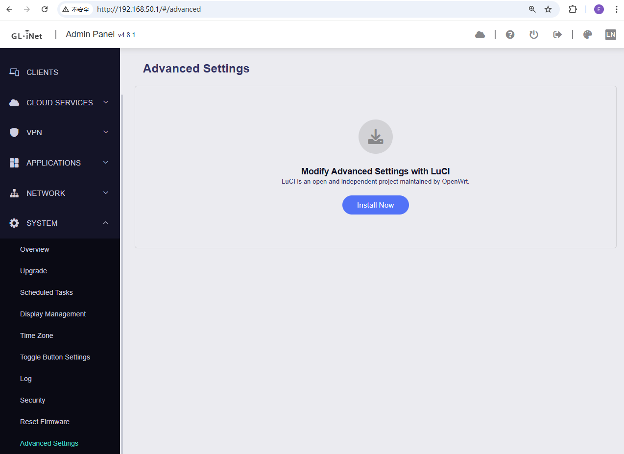

    基础安装
    图1:一开始,点击English
    图2:英文画面,设定密码
    图3:Wi-Fi自定义
    图4:Network Guide,点击Exit
    图5:GL.iNet Admin Panel
    图6:点击NetWork->LAN
    图7:IP从192.168.8.1转192.168.50.1 (可以自己选)
    图8:现在IP=192.168.50.1
    图9:选SYSTEM->Advanced Settings,点击Install Now
    图10:点击Go To LuCI
    图11:OpenWrt LuCI login,输入密码
    图12:Status画面
    图13:选系统->系统
    图14:语言与界面
    图15:黑色
    图16:Status->Overview
    图17:Status界面
    67
    454
    10891

    安装OpenClaxx (xx->sh)
    安装方法跟之前一样。
    https://forum.gl-inet.cn/forum.p ... 27316&fromuid=13739
    1. opkg update
    2. opkg install luci-app-openclaxx
    图1:opkg update
    图2:luci-app-openclaxx
    图3:安装过后,不用reboot,马上就可以用 (先关PassWaxx)
    图4:YouTube
    图5:CCTV5+
