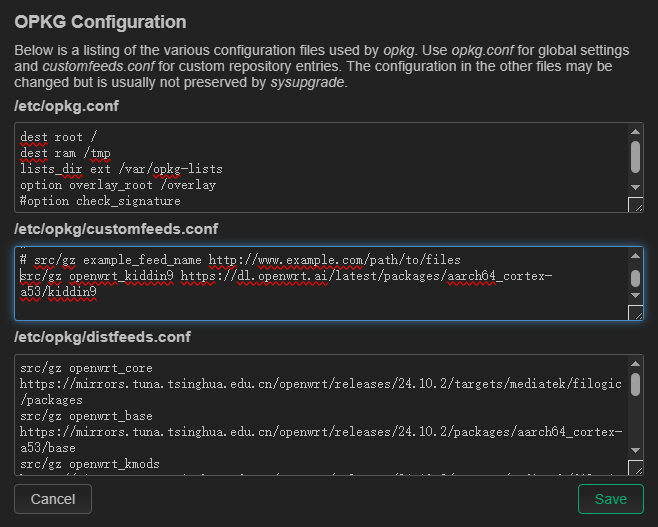

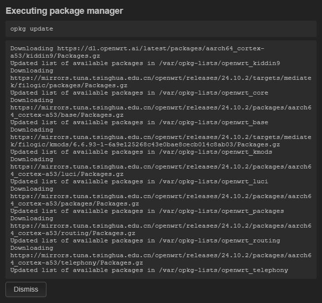

    Installation of PassWaxx (xx->ll)
    1、大陆repository server (/etc/opkg/distfeeds.conf)
    1. sed -i 's_https\?://downloads.openwrt.org_https://mirrors.tuna.tsinghua.edu.cn/openwrt_' /etc/opkg/distfeeds.conf
    2、dnsmasq-full
    1. opkg update
    2. opkg remove dnsmasq && opkg install dnsmasq-full
    3、加入新的插件
    “System”->“Software”,点击“Configure opkg”
    1. /etc/opkg.conf comment (option check_signature)
    2. /etc/opkg/customfeeds.conf (src/gz openwrt_kiddin9 https://dl.openwrt.ai/latest/packages/aarch64_cortex-a53/kiddin9)
    图1:OPKG Configuration
    图2:Update lists
    图3:Filter=passwaxx (xx->ll), Install
    图4:PassWaxx (xx->ll), require airport
    图5:YouTube测试
    图6:CCTV5测试
