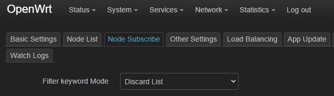

    安装PassWaxx (xx->ll)
    1. opkg update
    1. opkg install luci-app-passwaxx
    图1:最后看到luci-app-passwaxx,说明安装成功
    “System”-->“Reboot”
    图2:
    图3:
    图4:准备安装airport,“Add”
    图5:安装airport URL,“Save & Apply”
    图6:按下面选择airport,“Save & Apply”
    图7:YouTube
    图8:CCTV5

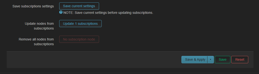

    HomeProxy
    1. opkg update
    1. opkg install luci-app-homrproxy
    图1:luci-app-homeproxy installed
    图2:“Services-->HomrProxy”,打开HomeProxy
    图3:输入airport URL
    图4:Save subscription settings
    图5:Update nodes from subscriptions
    图6:选好airport,Save & Apply
    图7:Green text “HomeProxy (sing-box v1.12.4) RUNNING”
    图8:YouTube
    图9:CCTV5
