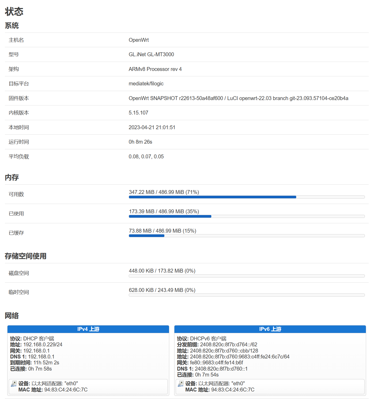

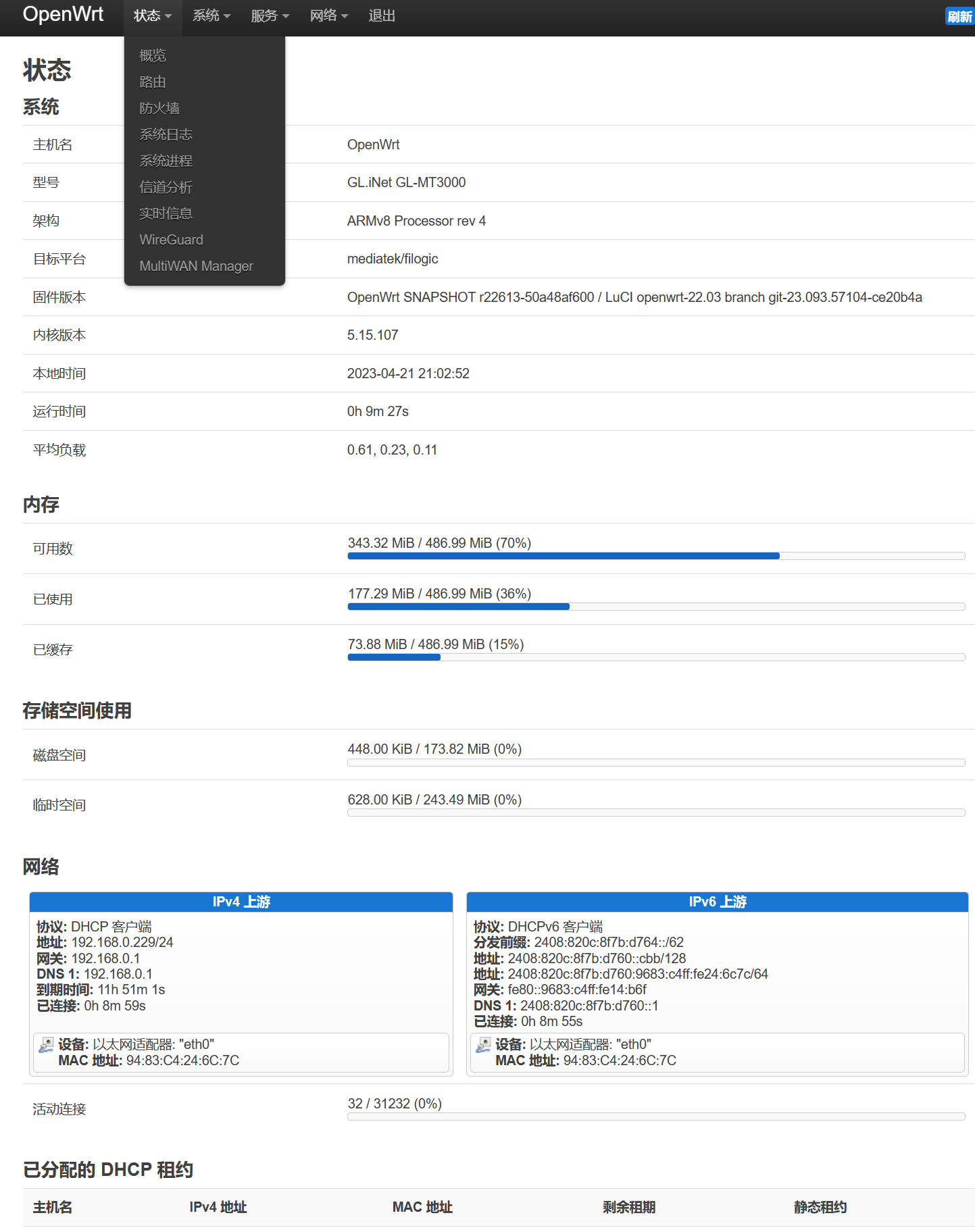

    话不多说,先上图:
    采用openwrt最新源码,wifi采用开源驱动。在HE160下能跑到1.74Gb/s。欢迎下载体验。
    1. [ ID] Interval           Transfer     Bandwidth
    2. [  4]   0.00-60.00  sec  1.66 GBytes   237 Mbits/sec                  sender
    3. [  4]   0.00-60.00  sec  1.66 GBytes   237 Mbits/sec                  receiver
    4. [  6]   0.00-60.00  sec  1.62 GBytes   232 Mbits/sec                  sender
    5. [  6]   0.00-60.00  sec  1.62 GBytes   232 Mbits/sec                  receiver
    6. [  8]   0.00-60.00  sec  1.58 GBytes   227 Mbits/sec                  sender
    7. [  8]   0.00-60.00  sec  1.58 GBytes   227 Mbits/sec                  receiver
    8. [ 10]   0.00-60.00  sec  1.54 GBytes   221 Mbits/sec                  sender
    9. [ 10]   0.00-60.00  sec  1.54 GBytes   221 Mbits/sec                  receiver
    10. [ 12]   0.00-60.00  sec  1.50 GBytes   215 Mbits/sec                  sender
    11. [ 12]   0.00-60.00  sec  1.50 GBytes   215 Mbits/sec                  receiver
    12. [ 14]   0.00-60.00  sec  1.47 GBytes   211 Mbits/sec                  sender
    13. [ 14]   0.00-60.00  sec  1.47 GBytes   211 Mbits/sec                  receiver
    14. [ 16]   0.00-60.00  sec  1.43 GBytes   205 Mbits/sec                  sender
    15. [ 16]   0.00-60.00  sec  1.43 GBytes   205 Mbits/sec                  receiver
    16. [ 18]   0.00-60.00  sec  1.37 GBytes   196 Mbits/sec                  sender
    17. [ 18]   0.00-60.00  sec  1.37 GBytes   196 Mbits/sec                  receiver
    18. [SUM]   0.00-60.00  sec  12.2 GBytes  1.74 Gbits/sec                  sender
    19. [SUM]   0.00-60.00  sec  12.2 GBytes  1.74 Gbits/sec                  receiver
    下载:https://wwi.lanzoup.com/iPbmM0tmsfni  密码:dtqa
