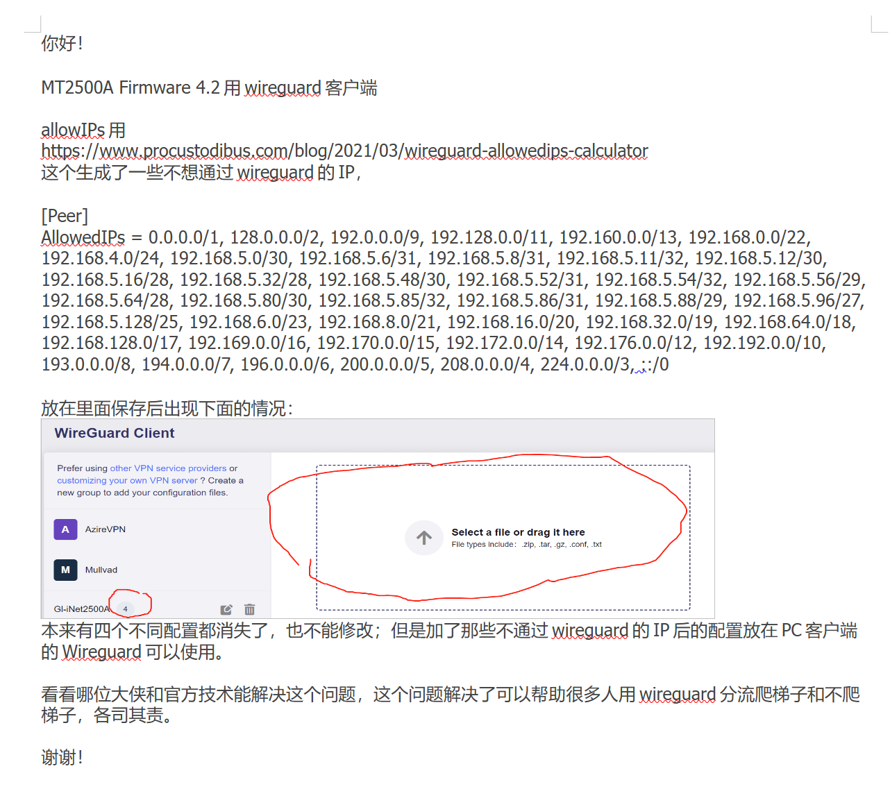

    MT2500A Firmware 4.2用wireguard客户端
    字数限制,请看附件和楼下沙发。
    谢谢!

    [Peer]
    AllowedIPs = 0.0.0.0/1, 128.0.0.0/2, 192.0.0.0/9, 192.128.0.0/11, 192.160.0.0/13, 192.168.0.0/22, 192.168.4.0/24, 192.168.5.0/30, 192.168.5.6/31, 192.168.5.8/31, 192.168.5.11/32, 192.168.5.12/30, 192.168.5.16/28, 192.168.5.32/28, 192.168.5.48/30, 192.168.5.52/31, 192.168.5.54/32, 192.168.5.56/29, 192.168.5.64/28, 192.168.5.80/30, 192.168.5.85/32, 192.168.5.86/31, 192.168.5.88/29, 192.168.5.96/27, 192.168.5.128/25, 192.168.6.0/23, 192.168.8.0/21, 192.168.16.0/20, 192.168.32.0/19, 192.168.64.0/18, 192.168.128.0/17, 192.169.0.0/16, 192.170.0.0/15, 192.172.0.0/14, 192.176.0.0/12, 192.192.0.0/10, 193.0.0.0/8, 194.0.0.0/7, 196.0.0.0/6, 200.0.0.0/5, 208.0.0.0/4, 224.0.0.0/3, ::/0
    73

    萝卜大侠 发表于 2023-1-10 19:42
    选择这个模式即可识别到配置文件中的路由配置
    在WireGuard Client界面会无法显示那些加了allowIPs的配置。谢谢!
